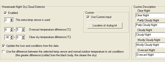

hi Brian
have the latest zip file running but I not getting the Outlook icon changing
please see attachment
overcast 6.5 c
for clear sky minus 25 C
the Outlook icon is not changing and is stuck on clear sky
Not sure what you mean by Outlook icon?
Do you mean main screen icon?
yes
sorry wasn’t sure what to call it
Try ticking use temperature difference
hi brain
I’ve ticked the temperature differential
sky conditions are clear at the moment , minus 18 C
will give you update tomorrow evening when we get partly cloudy sky conditions
thanks
hi Brian
is there any chance you could have another look
I’m still getting clear sky and no other conditions
Thank you
it worked here in testing with the file you had sent me originaly and the default temperature settings
i.e if I changed the sky temperature to be below the threshold for cloudy, that changed the icon
the best thing is for you to .zip and email me your settings file and the latest input file
in checking your settigns, you have the temperature threashold settings set wrong
they need to be a postive number, not a negative number (like the default value)
see my email for explanation
hi Brian
thanks for info
I have taken out the negative number, will see what happens this evening
give you an update later :smiley:
