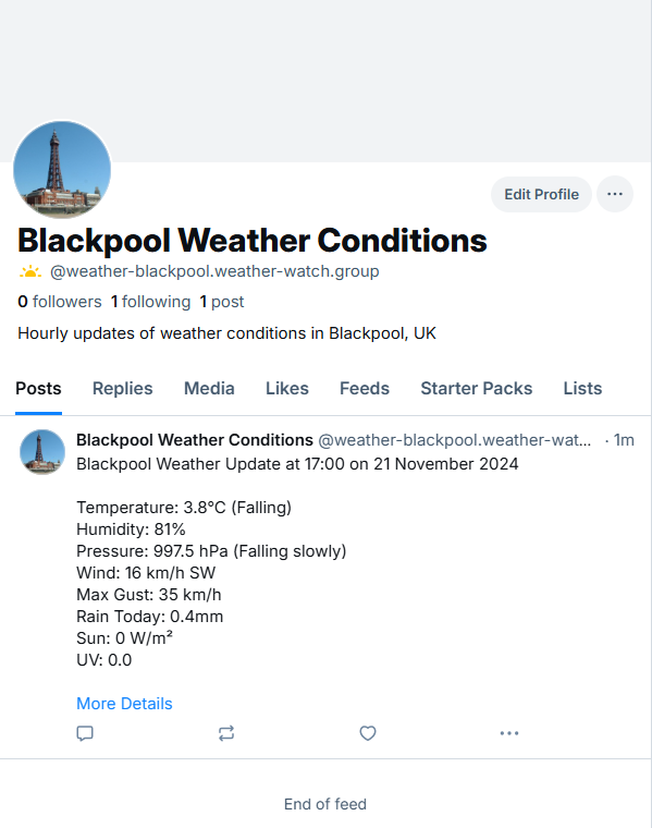

I'm auto posting hourly weather updates to Mastodon and Bluesky with some PHP, because, why not :)
After some additions to check that the data isn’t too old this is the first proper post to my ‘weather conditions’ account…
I just need to add the cron job now and it’s online.

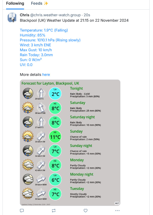

I’ve improved the post by putting a link on each value that points to the relevant chart on my website. So if you want to see more about the temperature just click on the temperature value link. See the current example at this link…
BSky weather conditions post including links
I’ve linked the entire line for now, but I’m wondering whether to just link the name string or the value.

Including those links is really nice. But I would indeed go for the option of only placing a link on the value itself to make it clearer it’s clickable and why.
Other than that I am impressed by your Python code (and how little seems to be needed).

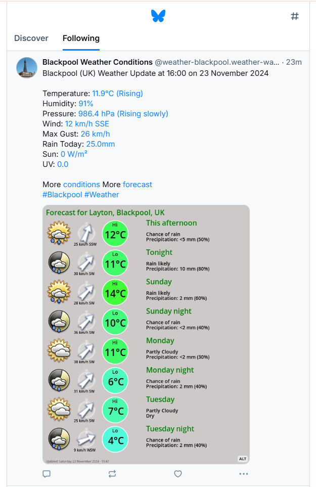

I think I’ve finished with this posting script, at least until someone suggests an improvement!
Latest changes are:
  1. The conditions links are now just on the values
  2. Checks if the conditions data is recent and doesn’t post if not
  3. Checks if the forecast graphic is recent and only posts conditions if it’s not
  4. Alt text added to the image. The alt text contains a text version of the forecast
  5. Changed the ‘More conditions’ link format and added ‘More forecast’
I have WxSim running every hour and the image is generated on the hour using the latest WxSim data. The BSky post is made a minute after the image generation runs.
