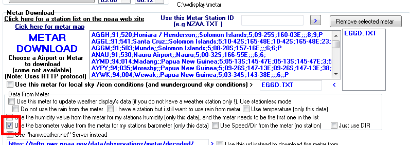

Hi, just to check - have you got the METAR download setup as mine? See attached image where I only have the barometer box ticked so that WD uses my VP2 for data except barometer which is obtained from METAR. Maybe WD is using all METAR data and as that data only updates every hour (some airports do 30 minute updates) then data will look flatlined.

It was set up the same way. It would remain flat line over night .
