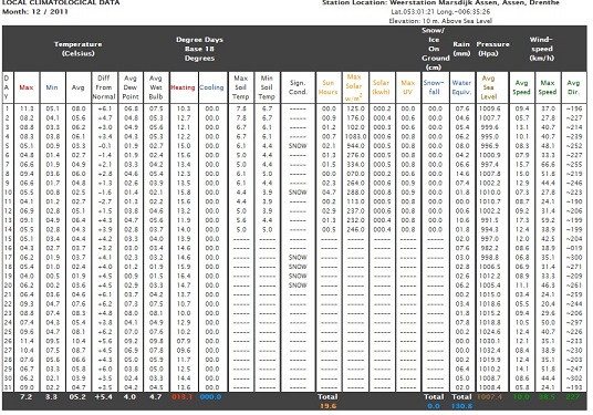

When I make a new detailed climate report, data is missing. See attachment.

When I make the climate data report from june, july…december 2011 I have same problem as on attachment (dec. 2011)
How to resolve this.

A part of data in detailed climate report is empty. (see post above this one with picture)

Did some investigation again.
It seems that all data is ok
I changed for a few seconds pc date to 31 january.
Now I could make al detailed climate repoerts from july till december 2011.
So my problem is resolved.
I have now all detailed climate reports which I needed and without wrong UV data.
Remains the fact that I had to change pc date to 31 januari to make this possible.
Not a big problem but…it should not be necessary.
EDIT: Brian, I would appreciate if this becomes possible to make correction to Detailed Climate report without changing pc date/time to 31 of the month.
