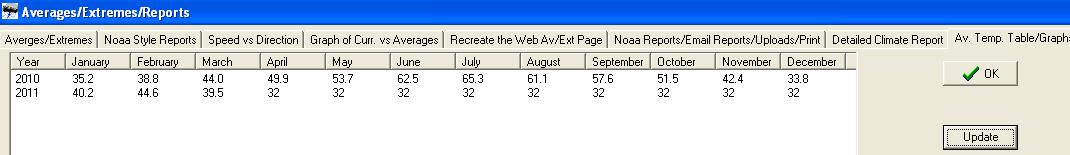

second q - how do i create the average temp condition graph in the noaa settings? it looks great.

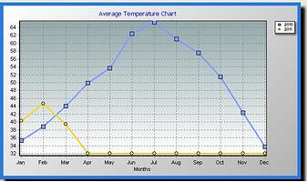

how do I get a climate graph ?
such as this one in av. temp/tables in the av/extremes noaa style reports:
