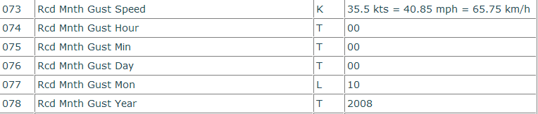

When I watch the records on my web site, the “Highest gust speed” don’t show the date on the month - only 00/
How to correct this?
I use the WDL v 6.03 and WD 10.73L
Thanks in advance

The data is coming from WD like that (see screenshot from the parser below) so this is really a WD question.

try setting those correct values in WD under action, enter my own all time records
not sure why they are 0 for you like that
Hi windy.
I just tried to manually set new hour and date on the maximum wind gust, but it set it self back to old data ](*,)

I just tested here
works correctly
make sure to click on set
and then Yes to save settings
Did it and saved ok, but still 00 for the date and time is incorrect as well.

note that you would need to wait for the data to get updated to WDL
when I set and saved, and clicked on OK
and then went back into that setup, the day/month/year I changed was remembered ok

Hi Bryan…I finally made it thanks to you
I forgot to tick the “month to date” field, but after that it shows ok.
Hope the next max windgust will show up correct next time with date.
