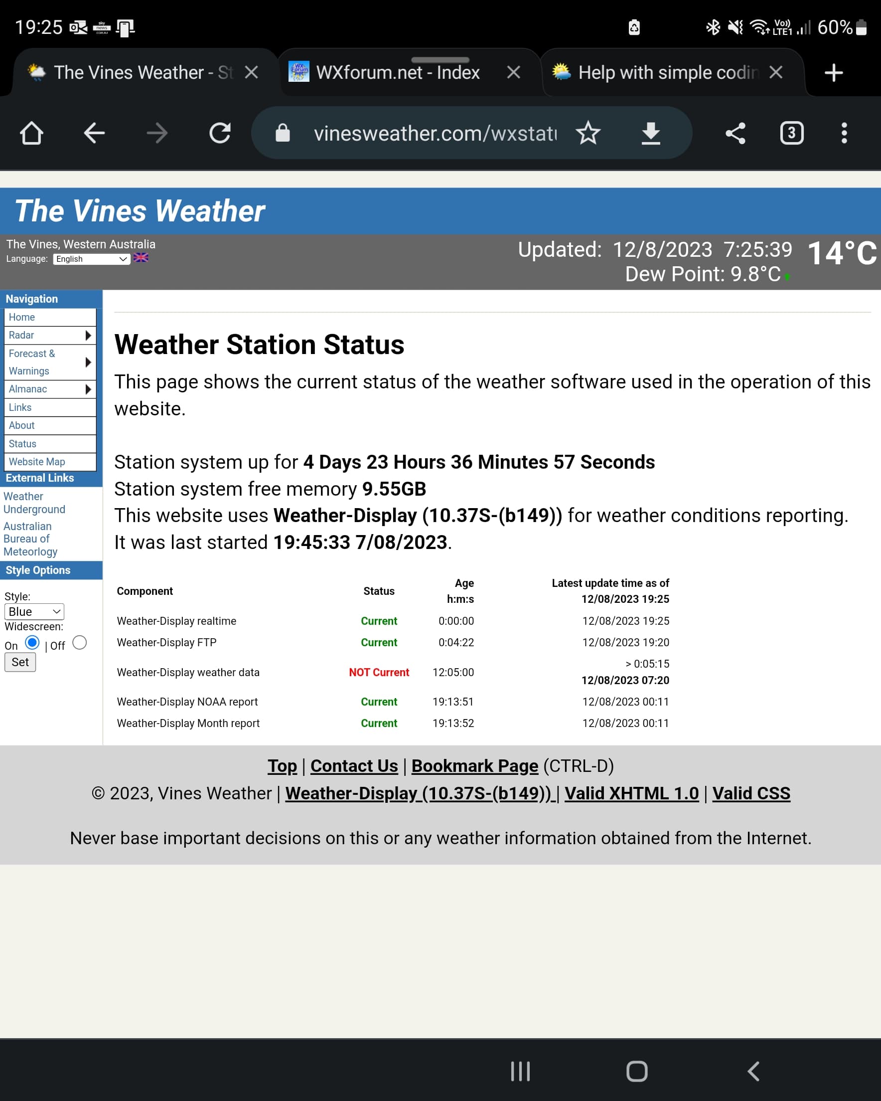

i just checked your status page again and i think your time zone in settings needs checking as the last update times are 8 hours adrift i should be seeing your time zone

Just had another look at your status page at 09:20 utc+1 my time and the last updates showed 16:20 which is correct but the WD weather data showed 12 hour adrift but I then noticed that the clock at the top of the page said 4:20 that’s AM which means that is the cause I think that time comes from the sever?

The native webserver timezone doesn’t really matter. The timezone for display on the website is set in Settings.php by $SITE['tz'] = 'Australia/Perth'; and that appears correct.
The -12hr offset in displaying times on the site is likely due to the system running Weather-Display is not set to use Perth local time. When the website first loads, the $date/$time in testtags,php is shown on both the gizmo and dashboard. When ajaxWDwx.js starts execution, the date/time displayed is updated from clientraw.txt. Both clientraw.txt and testtags.php show the ‘current’ date/time as being 12hrs before the actual time in Perth. When that is corrected, all the times should ‘line up’ to Perth date/time

Many thanks to you all. I’m still not sure why;
Weather-Display NOAA report
Weather-Display Month report
are 12 hours behind. I’ve looked at the PC, router, and server times and all matches up. So I’m looking at WD as to why these reports are 12 hours behhind.
I think the issue is the computer thinks it’s 4am rather than the correct 4pm or at least WD does at time of this post, and this is impacting all the files you sent to your website from WD
What is strange is that just before midnight your time it was wrong when I checked but at midnight it corrected itself
You may need to doubled check the time zone on the pc clock settings
If possible can you post a screen shot of the WD main screen that shows the clock and the clock of the computer
