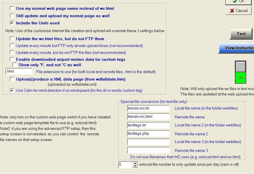

Still having an issue with the trends-inc.html not being ftp’d to the website. I have include a screenshot on the setup page so hopefully someone can spot if it is not configured correctly. Note the the testtags.php is uploading fine.
make sure there is no space at the end of the file names
is the trends-inc.html being created/updated on your pc?
Hi Windy,
It appears that the trends-inc.html is not being created or updated. There is an old trends-inc.html that I assume was created when I first set the site up but it has not been updated since. Testtags is being created and updated just fine which to me seems quite strange that this works but not trends-inc?
Dory
make sure that the template file (trends-inc.txt) is named correctly
i.e make sure you do not have windows set to hide known file extensions , in the windows folder (i.e it could be called trends-inc.txt.txt)
and that you do not have a space at the end of that file name in the custom web page setup, or similar
Hi Windy, checked all the things that you mentioned but nothing ws out of place. trends-inc.txt is named correctly and has no spaces. I have verified that hide known file extensions is off so I am looking at the correct file name. This is a tricky one!
Hi Dory,
It seems your http://www.users.on.net/~dory/testtags.php?sce=view is out of date
$time = "8:54 PM";	// current time
$date = "04/09/08";	// current date
and your http://www.users.on.net/~dory/trends-inc.html is not found (404).
Your http://www.users.on.net/~dory/clientraw.txt does seem to be current.
Your main site at http://jaspersweather.soho.on.net/ appears to have a current http://jaspersweather.soho.on.net/clientraw.txt.
It appears you’re uploading testtags.php to http://jaspersweather.soho.on.net/testtags.php?sce=view (which is current) and
yet the trends-inc.html is not found at http://jaspersweather.soho.on.net/trends-inc.html and the clientraw.txt there is somewhat out of date.
I think the issue is you’re uploading to two different FTP directories for your site, and the custom tags for testtags.php and trends-inc.html needed by the templates will only go to the primary FTP (not to the secondary one).
You should try installing the template on your main site (it won’t disturb your current site) and switch to using only one FTP upload. If testtags.php and trends-inc.html don’t upload there (after the change), then adjusting the upload interval for file#29 in the custom internet TAB should fix the issues.
Ken
