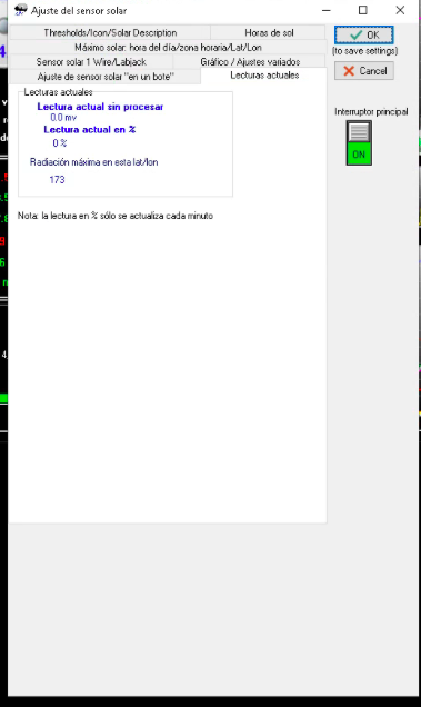

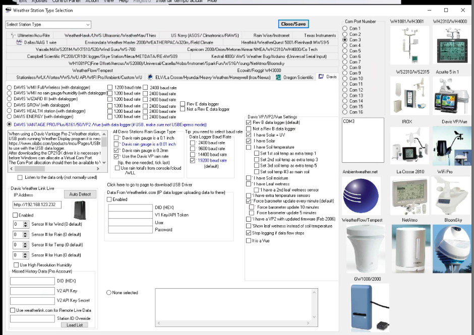

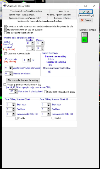

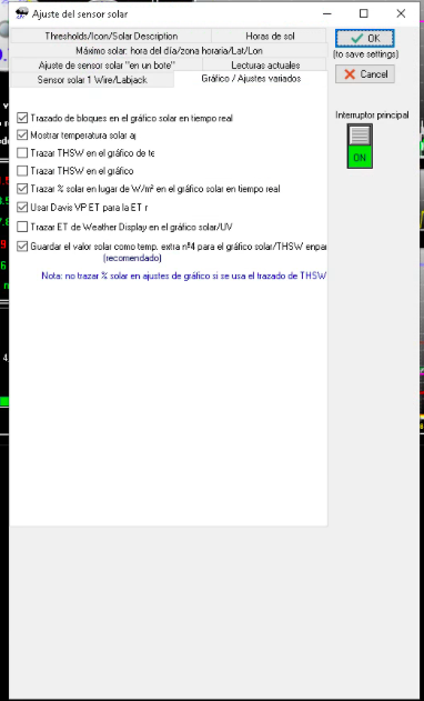

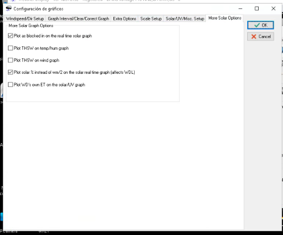

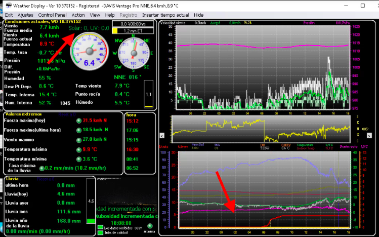

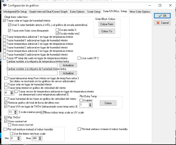

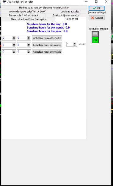

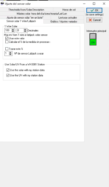

I’ve changed stations, I’ve installed a Davis vantage pro2 with a solar+UV sensor, and now I can’t see the data from said sensors in the WD console. I don’t know how to configure it. Before, I had it configured with 1-wire sensors, and I did see it, but now I’ve touched everything and I think I’ve deconfigured everything. Can someone help me, thank you. I’m attaching screenshots.

the solar in a jar needs to be set to 0 as not used and the items in the 1 wire tab need to be unchecked
It’s still the same; could someone please share their settings with me? :disappointed_face:
