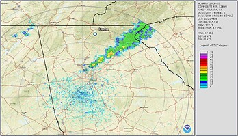

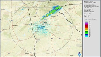

I am still working through the settings to reliably capture. I am capturing every 90 seconds (for my testing), using a static filename, which overwrites the file, and have WD looking at that folder, and doing an upload every 5 minutes. See attachment. WD is uploading every 5 minutes. When I have the screen on, everything seems to work. My issue is that when the screen goes to sleep, after a couple of hours, either the screen capture or the upload fails. I am crawling thru 8 hours of WD FTP logs and I don’t think WD is the problem. I am currently looking at the settings. I had the same issue using ShareX - the capture stopped after a period of time.

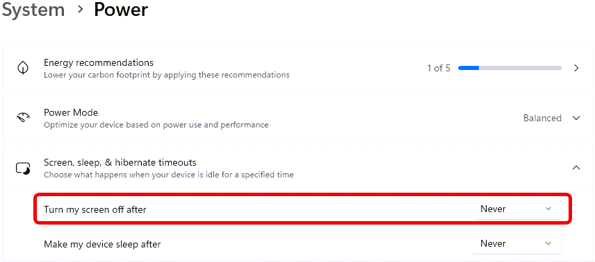

You might already be aware of this, but under Windows Settings → System → Power → Screen, sleep, & hibernate timeouts, you can select “Turn my screen off after” Never.

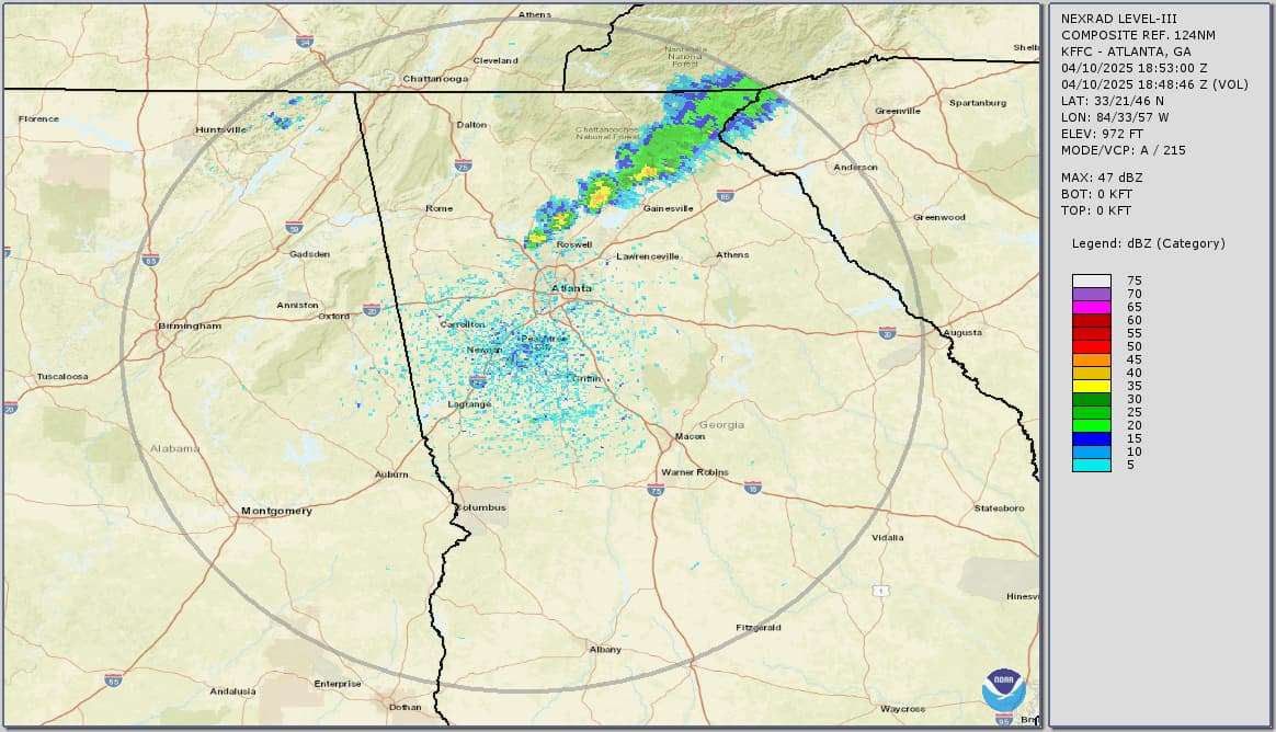

Poking around the NOAA websites i found a java app WCT-4.8.1 which runs well here and allows me to see a variety of Level 3 screens. I can select various reflectivity levels and composite reflectivity. I can manually save images as png files and apperantly as animations (although i haven’t quite figured that out yet.) I can automagically refresh on a timed basis as fast every 30 seconds. Best of all, its free.
Now, as i have oft stated, i am not a programmer, but perhaps one of you programmer wizards can adapt that java code to automatically save these images where they can be uploaded to our websites and viewed. There is a save to clipboard item and i could bring into paint without a problem. Automating this is just way above my head.
Sample attached.

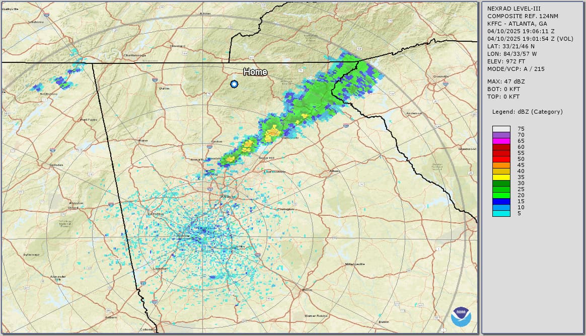

Edit: Zoomed, Range Rings and Home Marker added.
I think i have met the enemy and he is mine.
The NOAA Weather and Climate Toolkit is a free download and available here. Once you have it running, Go to data->data colllection by organization->Level3 and make selections from there. Save it as a favorite. You can add layers, markers, etc. When done, save the whole thing as a session, but you have to turn on the marker each time the program starts. On the left hand side Data tab go to favorites and set an autorefresh time.
I am using a mouse macro recorder to click the Save Image button, save it to a known location, i.e. /wdisplay/downloads. The mouse macro recorder is free and i am using MiniMouseMacro available here. Go to windows task scheduler and create a task to run, say every 5 minutes to run the macro that clicks the save image, selects the filename, clicks save and says yes to overwrite.
In weatherdisplay FTP/Internet setup->General FTP functions upload that file to the website, i use every 5 minutes.
The NOAA tool kit has to stay on top, it doesn’t matter if your screen goes to sleep.
My results can be viewed here. i am leaving the legend on for now so i can see that itis working and updating.
Voila, free Level 3 radar.
