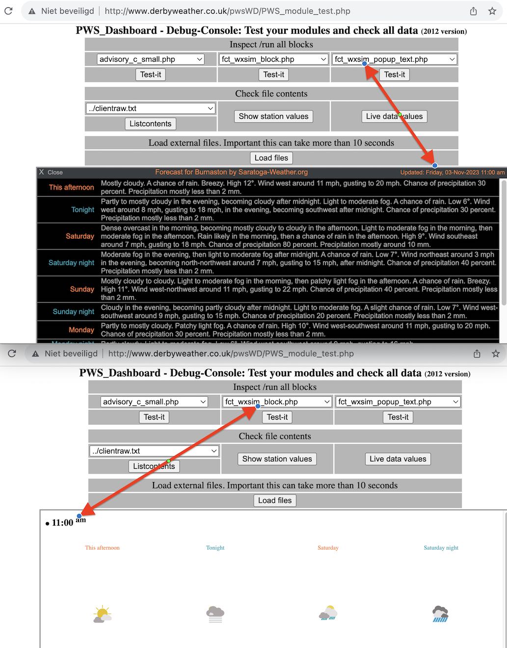

Your debug-dashboard . . . ather.co.uk/pwsWD/PWS_module_test.php
shows correct working scripts for both the block and the pop-ups. Albeit with very old data
WXSIM text forecast for Burnaston, initialized at 13:06 27 Dec, 2019
You can check here: https://www.derbyweather.co.uk/plaintext.txt that the scripts are using the files in the root, which is the most often used location.

Well, it is working correct when I visit your website.
Maybe you are using Cloudshare or another caching server?
So problem solved for me.
