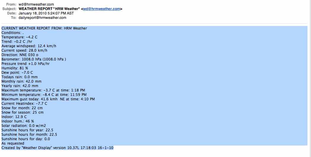

I am emailing the noaa reports to myself 4 times a day and it has been working very well. Is that what you mean? (I use to do this in case of a testing induced crash and as a backup)
Also, I do the climate data update at the end of each day and it also works well. See my site under Almanc.

So are you getting hourly rainfall breakdowns, Jim? I don’t mean the conventional monthly NOAA reports that has the max, min, avg temp, daily rainfall amount etc. I mean hour by hour breakdown of rainfall amounts.
Here are pics of the 2 reports I send myself. I suppose if you are sending the daily report hourly you would see the hourly amount. Mine are sent 4 times a day. I didn’t know there was even a NOAA report that broke it down hourly though which would be cool, but these seem to work.

Thanks. There is a way of sending hourly reports to yourself? I’ll check that out…that would be my bad.

oooo, I like that report too :slight_smile:
OK, you go to View>Noaa Reports, and Internet Setup, and select what you want from there . That’s how I did it. Mle sure you also go to Control Panel> Ftp&connection>email and fill in the server stuff there as well (for your email server)
