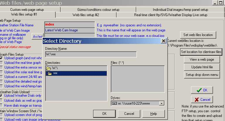

  1. The Windows version lets you select a DIRECTORY location for the clientraw files, separately from the webfiles location. I can see this in the registry entry NEW WEBFILES LOCATION which has separate entries for clientraw location, and location (webfiles).
    You can see where I easily set the clientraw to write into my mapped ‘W’ drive on the Linux server.

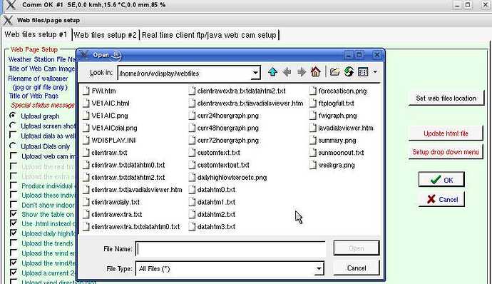

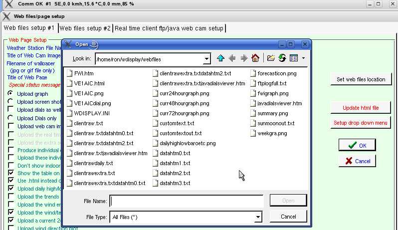

  2. In the Linux version there is only one button to select ‘web files location’.
    This button opens a file browser (see attached jpg) looking for a filename not a location (directory).

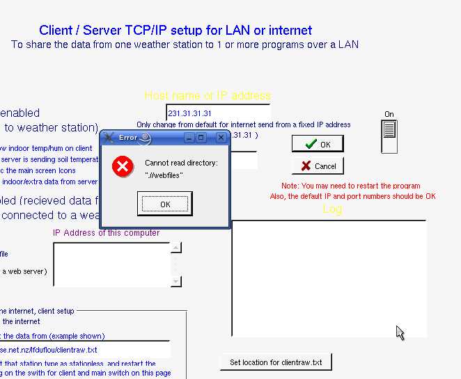

    If you try anything other than “./webfiles” (as in /home/username/wdisplay/webfiles) an error message appears saying "Cannot Read Directory ‘.//webfiles’ ".

In FTP/Client-Server setup, when you click on the button “Set location for clientraw.txt” a File Browser window opens and expects a FILENAME to be entered not a DIRECTORY (as in Windows version).
So my guess was to browse to my web folder and enter ‘clientraw.txt’ in the FileName box which enabled the ‘OPEN’ button, click on that and the browser screen closes. Ok so far but it doesn’t work.
Sometimes it ends up writing a new WDISPLAY.INI in the folder I chose, sometimes it does write clientraw.txt there…once (never updates).
If I come back to that setup screen and click on the “Set location…” button again I get the error message mentioned before "Cannot read directory ‘.//webfiles’ .

when you select a file (any file will do),in the directory you want to use, the directory is included as part of the file…and then WD strips off the filename you have selected and what is left should be just the directory
