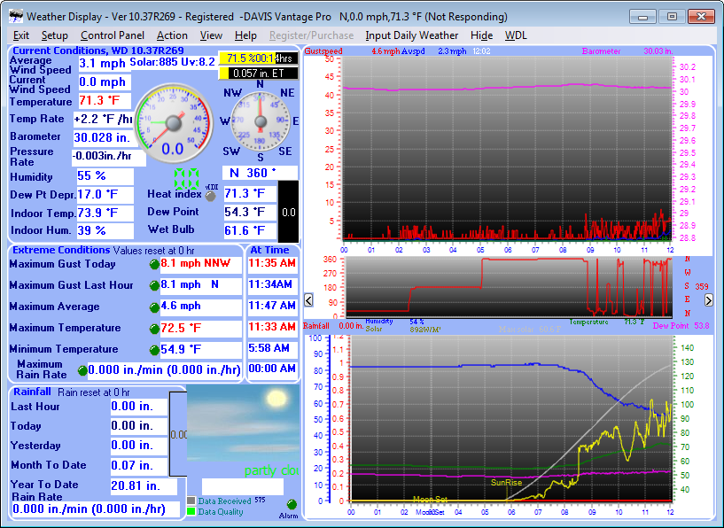

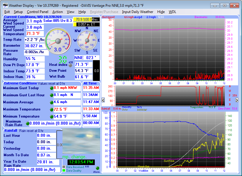

Tried the b269 .zip. The weatherdisplay.exe still ‘hangs’ in non-responsive mode periodically… reverted to b252
See attached screenshots
Ken
when you say periodicly…how often…at a certain time always, or?
About every minute at the :00 seconds, then about 20 secs later, it refreshes the main display. You can see on the first non-response image that the time display is a white-bar, then when it starts refreshing the window, the time display shows normally. Very odd-- seems to be off waiting for something. The CPU load for WD is just a whisper while this is happening.
Oh, let it run for about 15 minutes like this before reverting to 252.
