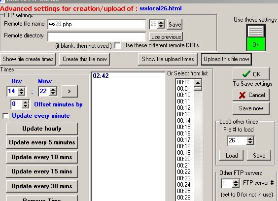

So I now have some wxlocal*.html files
WD each hour runs it to wx*.html
I open the file with notepad en safe it as wx*.php
upload and voila
as WD can upload it auto as html to my host
how to run a cron to rename all wx.html files to php :
rename wx*.html wx*.php ?
It doesn’t run in customize internet and file creation setup (see att)
