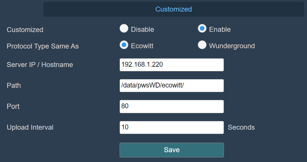

I have successfully completed all the required setup including that on the weather station via its IP address:
data = the local host that has been defined and tested as working

You might be having problems because the Server IP should only be the IP address. Try removing the ‘/data’ from it.

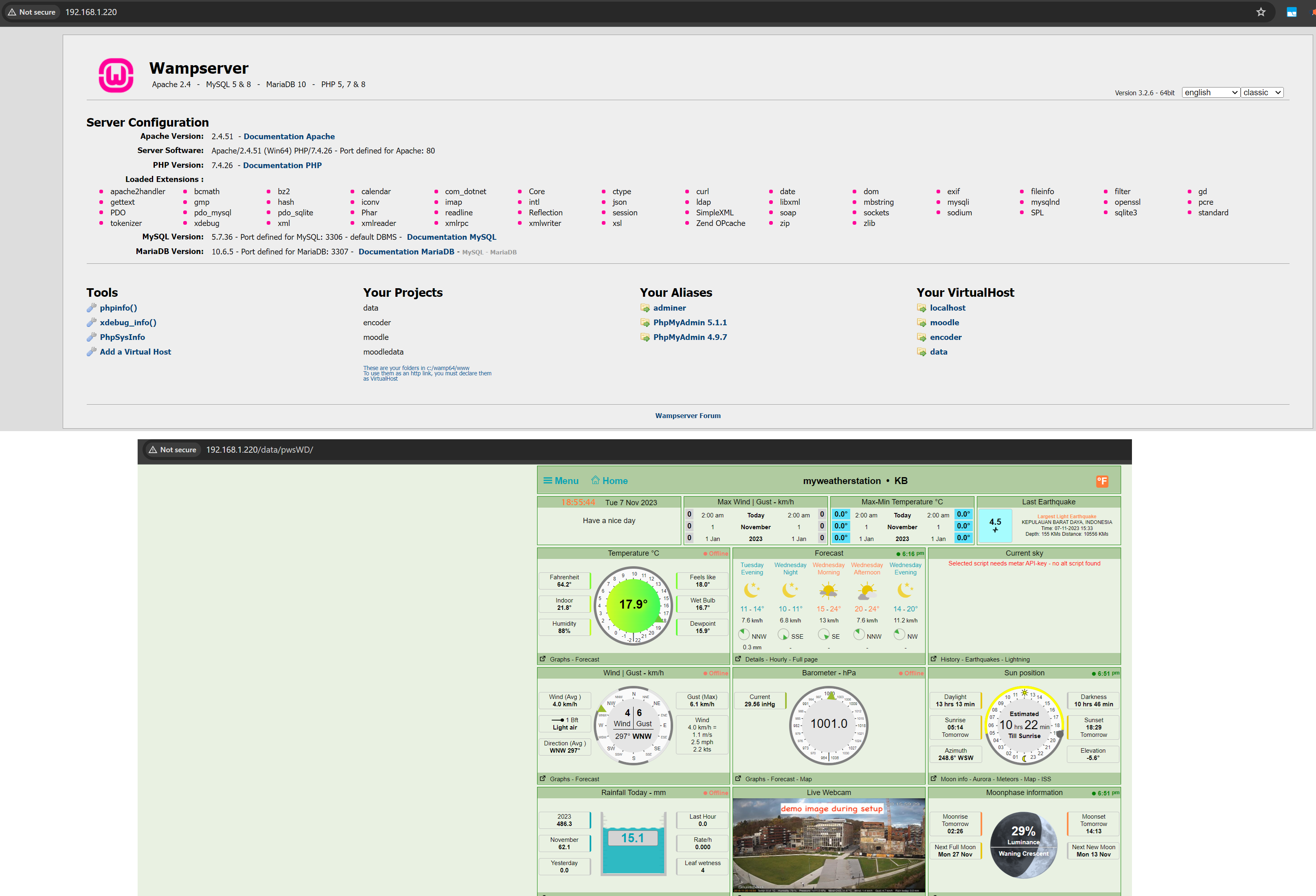

The problem is that “data” is a virtual host on the server that becomes the “website”, entering only the IP address will navigate to the WAMP dashboard:
By adding /data I can access the “website”:
Perhaps that is then my problem and my unit simply won’t work with a local WAMP site.

Please test local in your browser with 192.168.1.220/data/pwsWD/ecowitt/
You should get an error message about missing passkey… And in the pwsWD/ecowitt/ folder there should be a log file updated with the error message also.
Also check if there is a .arr file with a current time stamp.
You mention “does not appear to connect” but if there is a recent .arr file, that file arrived from your weather station.
If there is no .arr file you can test with only the ip-address in the server IP address field and add the /data before the /pwsWD string in path

In fact, only the name or IP address of the destination may be entered under Host/IP address - without http and without any other characters.
So please enter 192.168.1.220 there and then /data/pwsWD/ecowitt/ as the Path
These settings should then be correct.

It is working now.
It was as simple as changing the paths as you directed:
