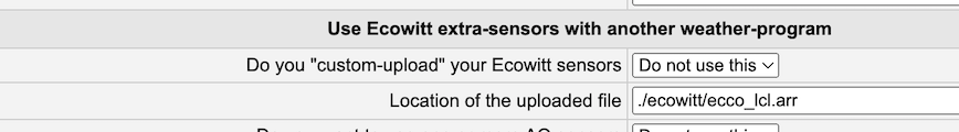

Please run easyweather setup, do not change anything, only press the green SAVE button.
That will reset the file locations, if there has been a change.

You have set both ecowitt for you main data file
=> easyweather tab Data
and ecowitt extra file
=> easyweather tab Devices
That Extra Devices settings should be switched off as your sensor data is already in the main upload.
Also, the extra file ./ecowitt/ecco_test.arr is old
Filetime: 2023-11-06 16:26:02 UTC => Age 12 days 4 hours 20 minutes 46 seconds
When using this setting the filetime of the extra-file overrides the normal upload-file filetime for the AQ-sensor and the lightning-sensor.
That is why the off-line message is shown for the station AQ sensor.
Your easyweather Ecowitt extra sensors should look like this:
Thank you sorted was Custom upload
