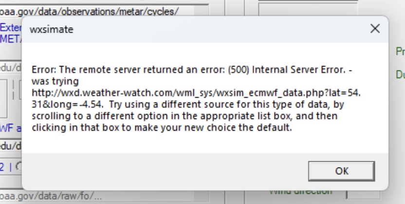

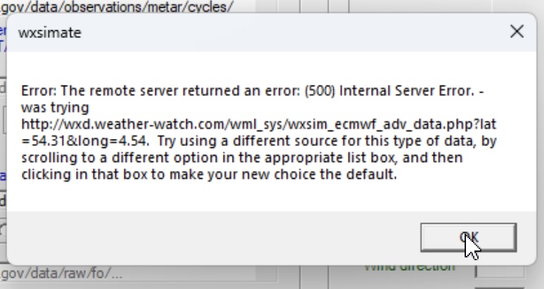

I have just found that WXSimate is failing to download any ECMWF data at all it is getting a server error 500 on each attempt.
That’s weird. 500 is usually a PHP code error but I’ve not changed any of the PHP code or the underlying data. I’ll investigate once I’m properly awake.
Thanks Chris. I did try more than once but it failed each time. Just tried again and it’s still happening.

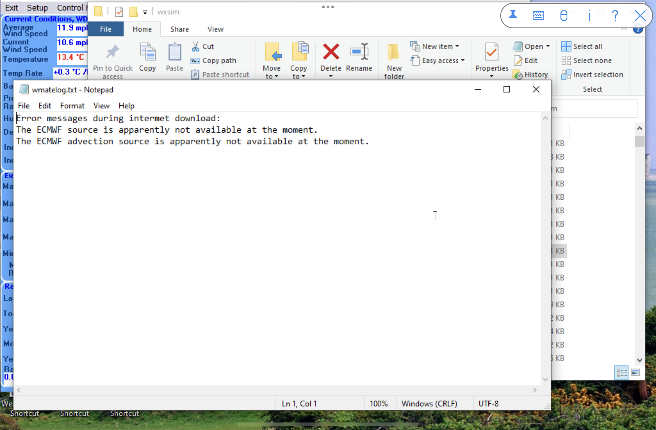

My log shows
So not getting the data

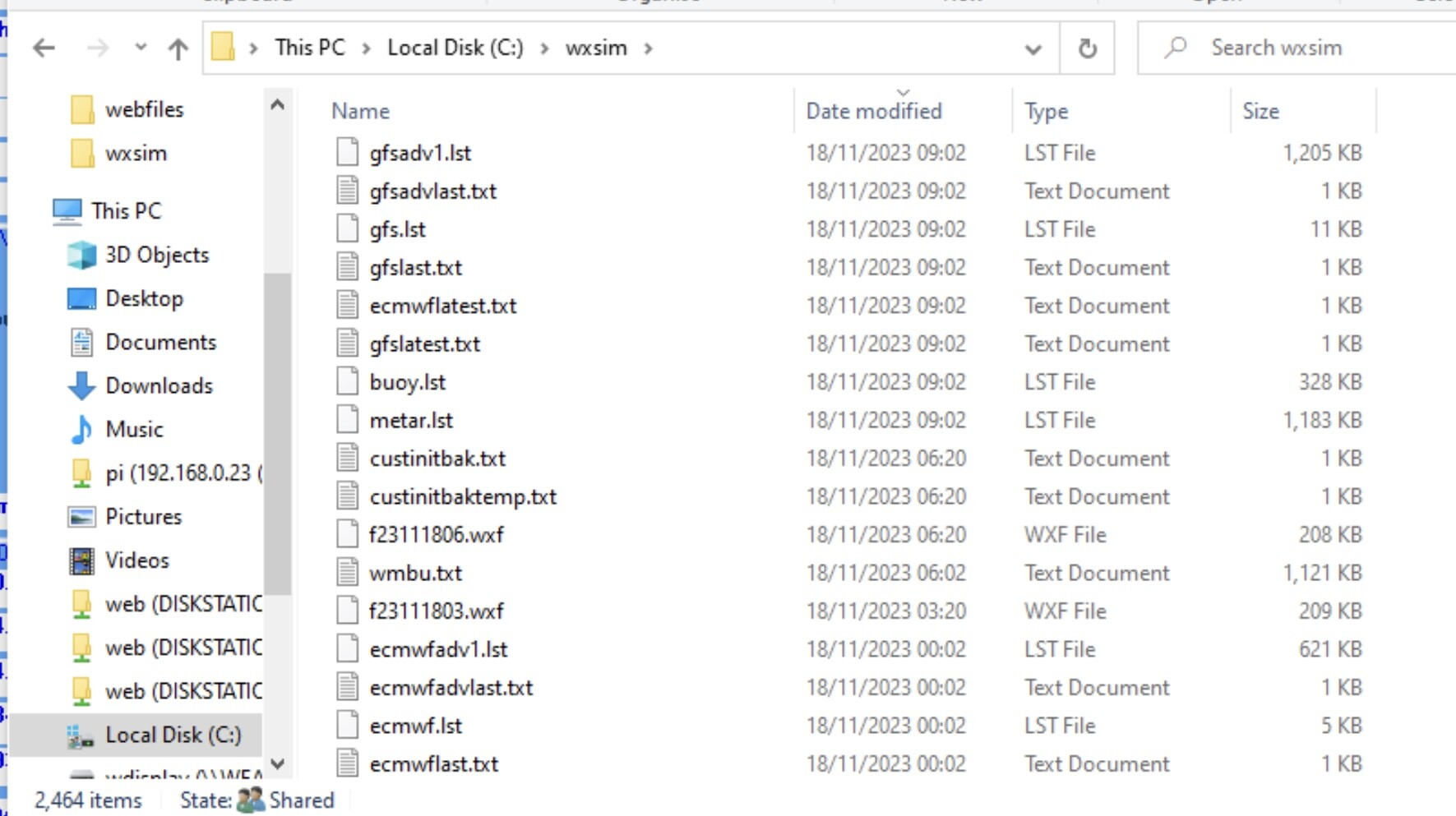

Last data is for 17-12
Some of the ECMWF logs last updated on my midnight download

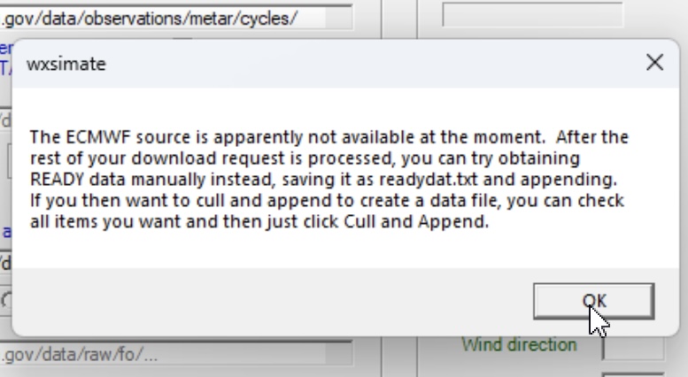

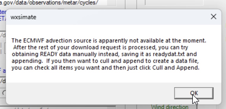

Just tried manual download and brings up these errors
These do not show on the auto run only manual download
