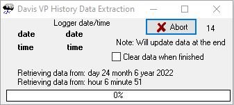

Recently moved from a Meteohub to a Meteobridge on RPI. My datalogged connected to a Vantage Vue console is a Weatherlink IP. Weather Display is set to connect via IP to the Meteobridge address, Port 22222. I do NOT have the box checked for either “Meteohub” or “Meteobridge in use” – that is, I am using the Meteobridge in pass-through mode to the Davis datalogger. Receiving live data works fine. What is not working is extracting data from the datalogger after WD has been shut down for some time. Instead, the history/extract screen gets stuck until I click Abort - and then it starts logging live data. The debug window shows the following as the latest example. In this example, I tried to set the “date to get logging” from 2:59 PM, exited WD, edited the logfile to just before this time. Here is the debug window. Any help appreciated:

Yes, I get the same behavior – the Davis VP History Data Extraction window appears at WD startup, and the number in the upper right corner increases but the bottom stays at 0% and does not pull the data from the logger. I need to click Abort to get WD running (and I lose the data from the last time WD was running)

Scratch that. It worked once… I rebooted the PC and started WD again, and once again its stuck at 0% with the upper right counting up and not downloading data from the logger.
