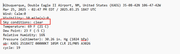

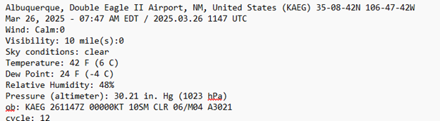

  • Contents of the Metar text file located in the WD\metar folder showing the sky conditions are clear (sunny).

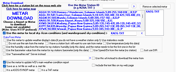

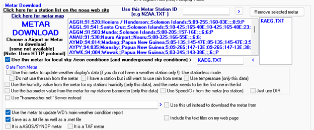

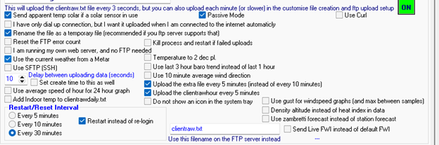

Here are the 2 config screens within WD that I believe are responsible for the current Metar conditions and how they will be used:

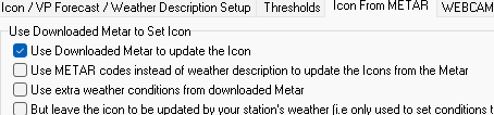

Try this setting in the control panel:
Jim
Thanks! I did not have that ticked, and now ticked it. Only thing that changed is the clientraw.txt is now showing clear, but the # is still 18, and the icon is being selected as cloudy instead of sunny / clear

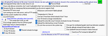

Thanks Jim for checking on your side! Unfortunately, I just checked now (about 1 later), and this is what I am showing:

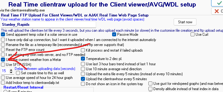

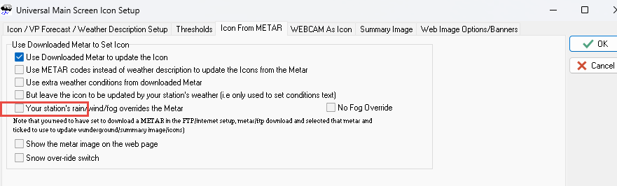

How about this one: Control Panel->Summary Images & Icons
Jim
Thank you! I had another option ticked as: Your station’s rain/…
Once I unticked that option, the icon looks to be working properly now.

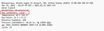

KAEG.txt metar file from WD\Metar folder

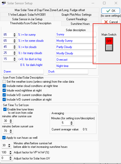

and look at your solar setup in WD and just turn it off, if its turned on.
Jim
Hmm… I do have day_clear.gif in the ajax_images directory
Interestingly you mentioned ‘Solar’ I did have that running at one point, but sensor went bad, so I turned the main switch for it to Off until I get it replaced. I wonder if there’s some interference from it causing this strange issue even though it’s showing off?

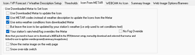

This ICON setting is complicated business, as you have found.
You can use a METAR to set the conditions icon, but since your solar sensor is offline, you have to uncheck the Solar sensor overrides during daytime.. that’s the reason you have ‘Overcast’ as the icon .. your solar sensor is reading zero (overcast and gloomy).
The testtags.php has the conditions icon of 5 (partly cloudy) which is the default for WD when no METAR nor Solar sensor is used. It would stay that way all the time until it either rains or has high wind.
Fully disable your solar sensor in your WD setup and configure to use METAR for icon both day and night with override for local wind/rain.
