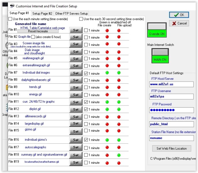

I’m having an issue with ‘Internet File Creation & Uploads’ in the Control Panel, file #7.
I’m trying to get the files to upload every minute. The 1 minute box is checked.
When I click on ‘Show File Creation Time’, the box showing the times is blank.
Same with the ‘Show File Upload Times’.
What am I doing wrong?

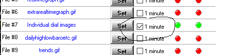

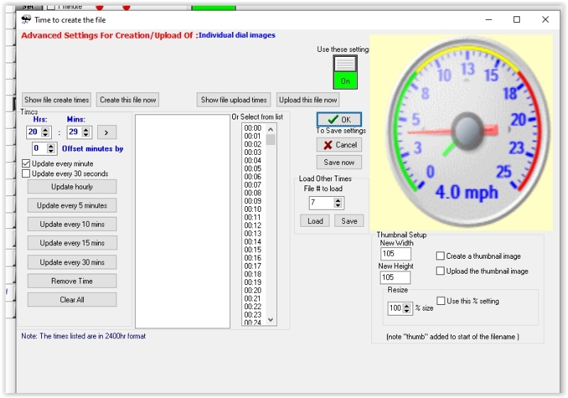

In the first attached jpg, I click on ‘Set’ for file #7.
This takes me to the second attached jpg. I click on ‘Create this file now’, then ‘Upload this file now’. The file is created and uploaded but never updated.
I then click on ‘OK’ which takes me to the first screen where I click on ‘OK’.
Clicking on the ‘Show file create times’ and ‘Show the file upload times’ displays nothing so I don’t use those buttons.
When you click on ‘Show file upload times’ is the update every minute box ticked there also?
Yes it is - just like in the screenshot. Is the times window supposed to display times when ‘Show upload file times’ is clicked? If so, mine stays blank.

With the 1 minute tick mark selected, there is no gif updated every i minute, just the initial create gif.
There are no entries in the program event log at all.
I just turned off the 1 minute tick marks on both screens (above) and chose 5 minutes for create and upload times. The gif is now created every 5 minute.
It just doesn’t work for 1 minute upload times, which I prefer for rain on my webpage.

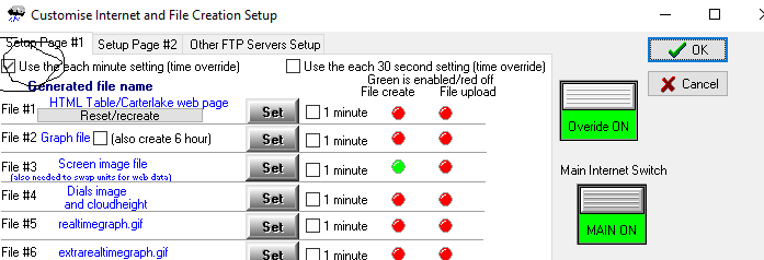

there is an extra are you sure you want to do that setting you need to also tick
see the screen shot
but also make sure you have the 1 minute override ticked in the top left hand corner as well
see override…attached screen shot
then make sure you hold your tongue just right 8O :smiley:
Well hidden and all is well now! 8)
Gotta Love it #-o LOL
It’s still working fine :smiley:
