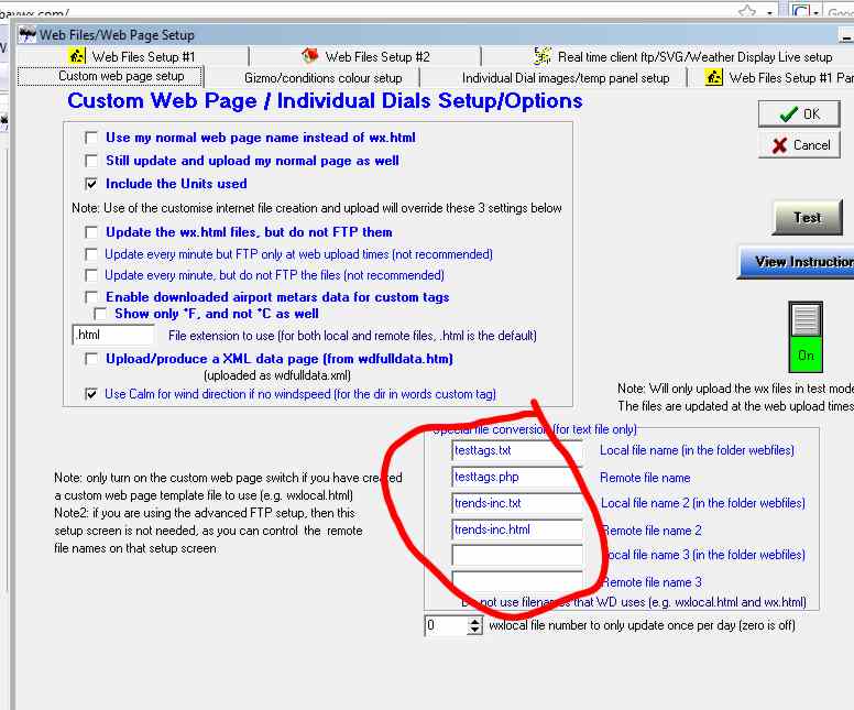

You’re uploading it more than one it seems.
Does your file creation screen look kinda like this?

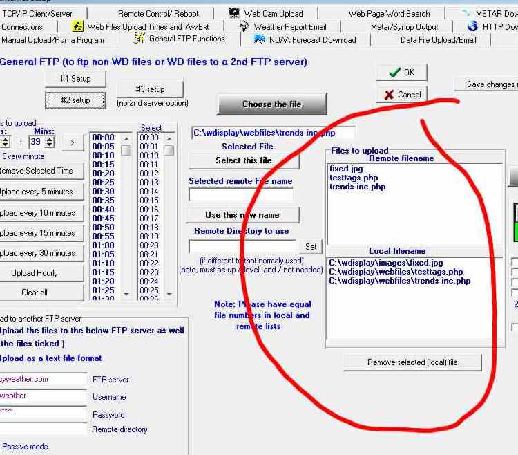

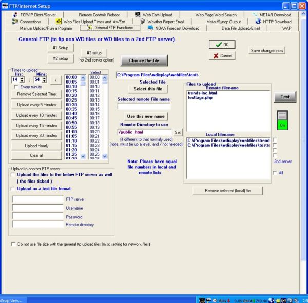

I’ve got that…but I also have this one as well.
Not too sure why. Had this thing set up last year and not paid too much attention to anything since the new version this spring.
That was a way around uploading the files if you couldn’t get file #29 to do it in the advanced internet uploads.
I’d remove the two files from the General FTP functions area … WD doesn’t parse any of those files for WD variables, so it won’t keep things current.
Use the Custom Files as Tony showed in his posting, then you may have to set an upload interval using the Custom WebPage/Webfiles Setup#2 TAB, file#29 to establish an interval.

I upload the same way you do. Dont forget that when you change the testtags,
go into the custom web page setup and test it so it regurgitates a fresh copy
of test tags, then try uploading it again
O.K.
Up and running again folks with the correct moon phase showing on the main page. I had previously replaced the testtags file with the distribution file but that didn’t do anything. When I deleted the uploading off of the FTP section and then I recreated the special conversion off of file #29 and it seems like the recreation of the file did the trick. Not sure why but just glad it’s working again and thanks all for your assistance!! :wink:
