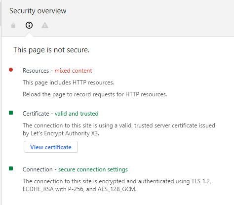

Attached is my Chrome security info:

So am I, but my security says secure. . .

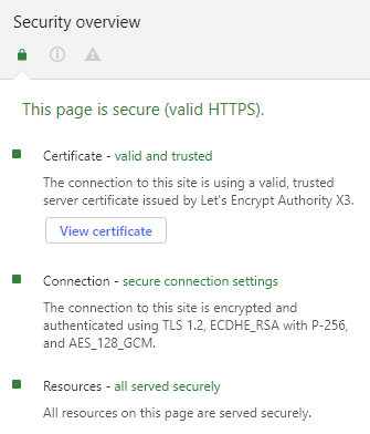

If I do it now that we are on page 8 of this thread it is all secure now for me too.
The reason it wasn’t fully secure on page 7 is because of broadstairs’ banner that is an external link and that content in his signature is http: (not https:). People’s signature’s that are http: links are not the cause of this problem.
Go ahead …retest yourself on page 7 of this thread. (make sure you have enabled to show signatures though).
