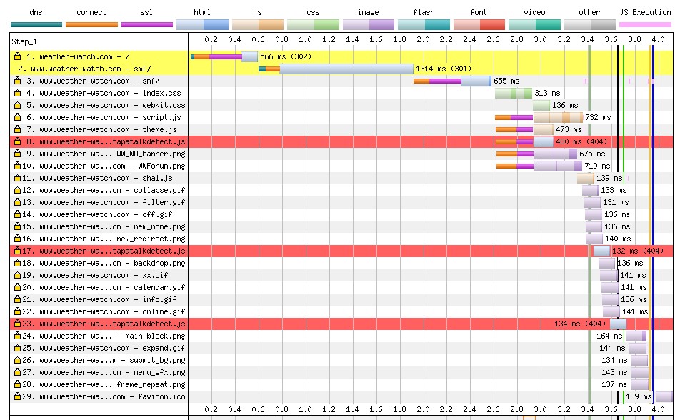

This HTTPS URL:
HTTPS://weather-watch.com
redirects to:
HTTP://weather-watch.com/smf/
notice it is doing a redirect to non HTTPS. (sorry had to put those links in code notation because the forum was appending extra HTTP in front of my text. Eventually it settles on HTTPS but it doesn’t happen as it should initially.

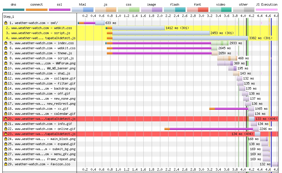

Then the other problem could be a number of 404 (page not found) errors in regards to Tapatalk mobile app support
…even when you go to the proper HTTPS with /smf/ path added there is still a redirect to non-HTTPS and I think there is a problem fetching 3 files from non-HTTPS URL.
webkit.ccs
script.js
tapatalkdetect.js
I think it eventually times out or redirect to fetching the same files over HTTPS including two more files: index.ccs and theme.js and these take a long time too. The tapatalkdetect.js over HTTPS fails after a long wait this next time over HTTPS because it can’t find it.
It tries to load tapatalkdetect.js two more times but the subsequent times it is over quickly but also with a 404 error (not found).

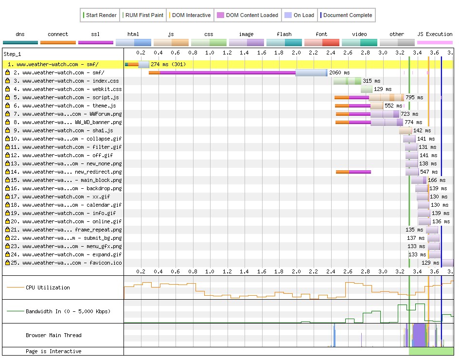

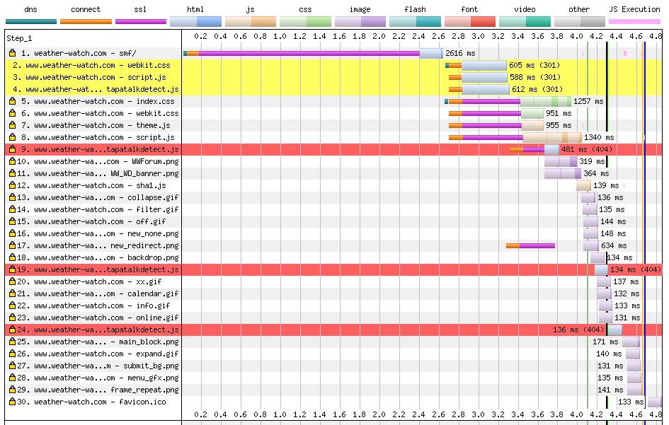

Attached are results for two separate requests described above for (I just think they are different because it was cached)…still shows same delay issues in retrieving these files:
HTTPS://weather-watch.com/smf/
By the way those delays that I showed tested are showing upwards of almost 5 seconds. That feels like an eternity. Then when the website is more busy I’ve seen those test last up to 20 or 30 seconds. I should have kept those long delay results but I didn’t think of it back then a few days ago. But the results were the same back then with it showing problems in those first file connections at the top of the graphs I attached…they were just longer. Then the ending parts are quick and short and load up fine.
