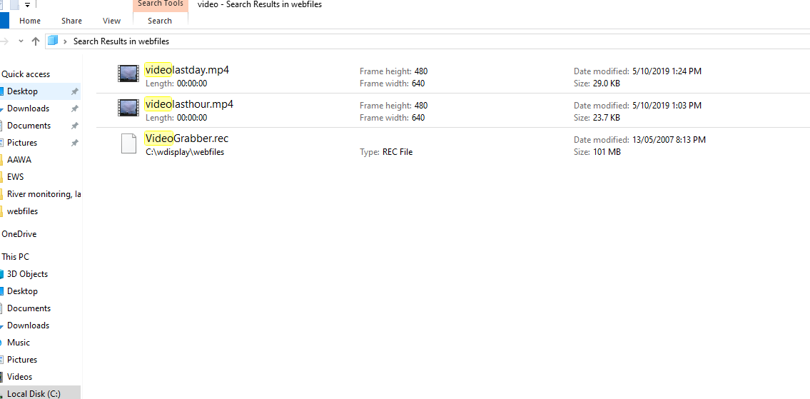

Hi Mate,
Like the attached.

By same thing I mean online, on the video link i posted the videos are doing the same thing locally (on my computer) as on my webpage. What I mean is in troubleshooting, this seems to be a WD issue rather than a webpage or uploading issue. Even when i click the create all day video now it creates a video that is 0mins long and very small. See attached.
This was all working well upto 4 or 5 days ago. I have the moviemaker.exe program but cant find that log file you speak of.
