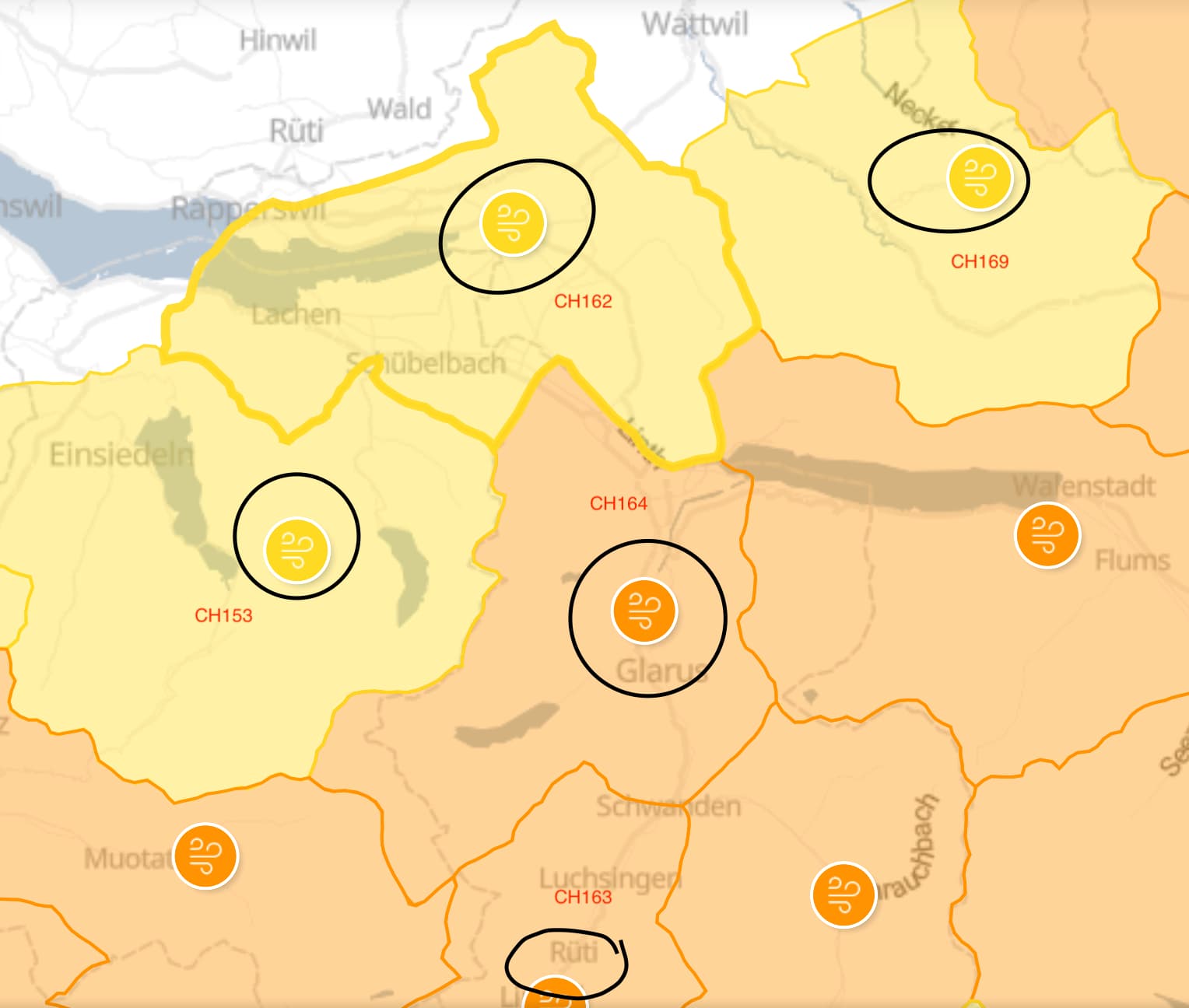

I have actually some problems with meteoalarm.org. There are some active Meteoalarms of my region, but they will not be shown in my pws-dashboard. Has somebody the same problems ?

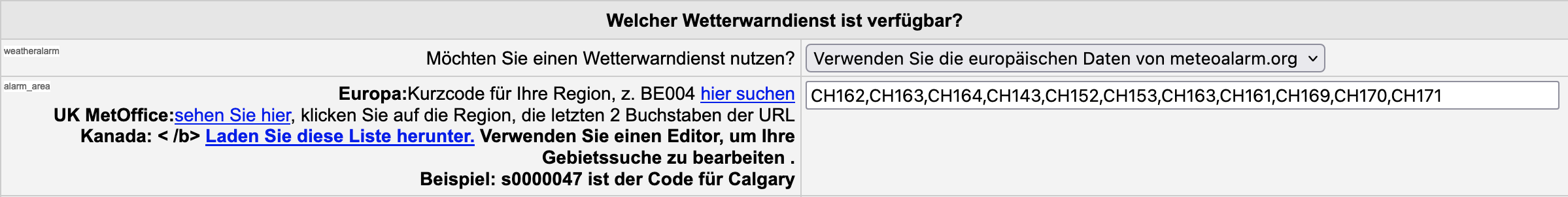

Configured Meteoalarm regions: CH162,CH163,CH164,CH143,CH152,CH153,CH163,CH161,CH169
Script used: wrnWarningEU-CAP.php, but with the script wrnWarningEU-ATOM.php the same problem.

Thank you for your reply, here are some area codes with active meteoalarms, which should be shown.
As I understand, in the feed of the meteoalarms, the area codes will not be submitted, only the names of the area and this is the problem, why the meteoalarms will not be shown in the pws dashboard.

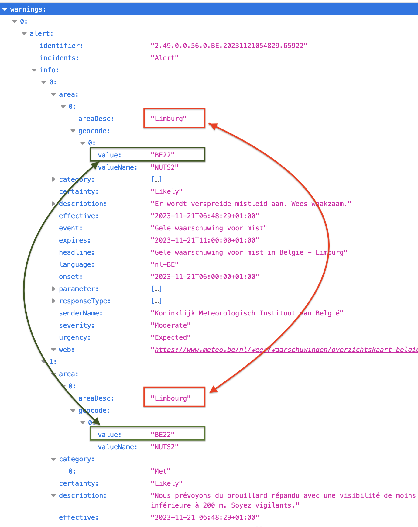

Each downloaded file has an array [warnings], with a key 0,1 a.s.o.
Each warning has 1 [alert] with no usable data for us
Each [alert] has 1 [info] array with all information need with key 0,1 a.s.o.
Each [info] array member describes the same warning in a different language
Therefor each [areaDesc] field can and will have a different value based on the language used for that description.
English:
That is valid for 1 language only
Only the [geocode] is a unique identifier.
Using the [areaDesc] field needs a lot of user maintainable settings.
For each official language used in a country a correct string has to be entered.
And the persons who upload the warnings should not make a typo either.

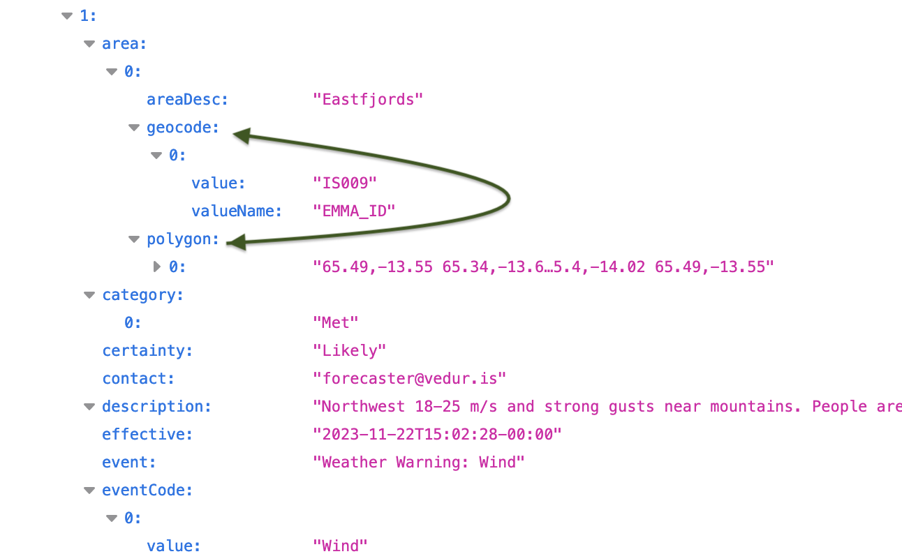

Another approach by Iceland.
They keep the geocode and added the polygons to be used on maps a.s.o.
Minus (small): That will still make the files larger.
Plus (large):
  • No overhead of “inside-outside-code”
  • Adjacent areas possible
That is the way all countries should go.

We have actually some meteoalarms in my region, but no meteoalarms will be shown in the PWS Dashboard with the new files of meteoalarm_polygon.zip.
In the configuration of PWS Dashboard, what I have to configure in the geocode line ?

You should leave the area codes as is.
If Switzerland re-introduces the area-codes they will be used immidiatly wihout to have to use the lat-lon code
