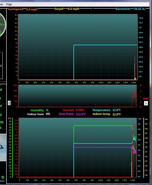

we had a brief power outage today which took down my WD system (so much for the UPS it’s connected to, which tests “good” – not a good sign there, but that’s besides the point).
when I restarted the system, the graphs went all kinds of funky – see attachment – I lost all data for the past 24 hours, and the timeline at the bottom reads on a scale of “0” to “1,500” instead of time of day.

Hi Joe.
Try to go to Action → Convert WD Logfiles to data files
Click on convert and then click on recreate last 31 days data files.
Have happened to me aswell several times due to power cut, don’t know exactly what causes the problem.
thanks, john. that seems to have fixed the graphs.
