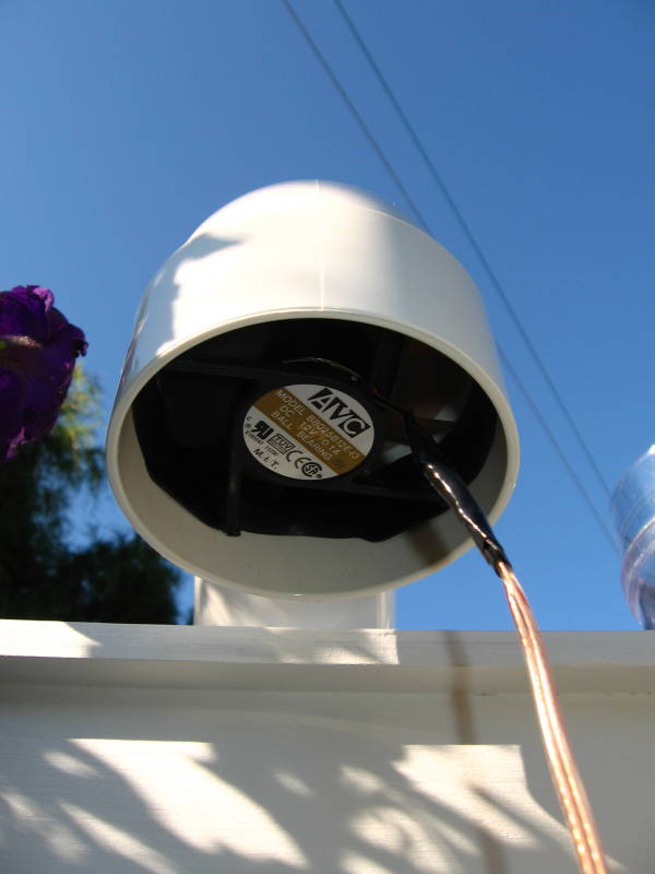

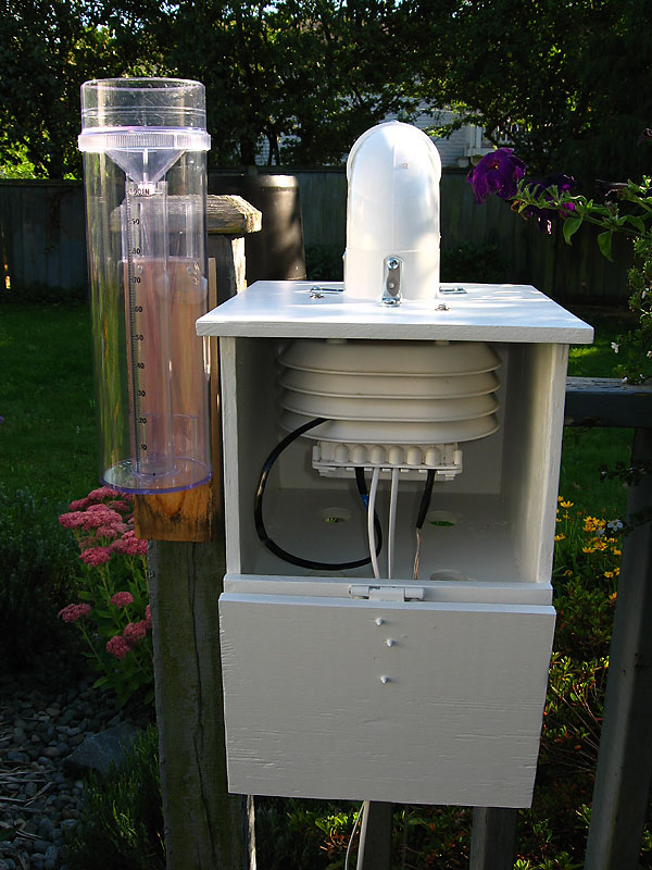

Not impressed at all with my FARS so far. Daytime temps are running noticeably higher now and nighttime has improved very little, if at all.
All things considered it was better in the old location without FARS.
I’m running a PC fan 24 hours on a 9V DC adapter. I may increase that to 12V but I don’t see it making a huge difference. I may also remove some of the plates on the shield to increase airflow. Ideally, I think air needs to be flowing right over the sensor itself.
Looks like you would be better off putting slats in the side of that box…all I see are 4 holes in the bottom for airflow. I bet it gets very warm inside that box when the sun hits it…
Yeah, probably. I was hoping the fan would provide sufficient airflow to keep the air inside fresh. I wanted to keep the design simple, but I guess that was a mistake.

Yes Dan, it is a PC PS fan working as an exhaust fan pulling upwards over the sensor, grass field all around.
TokKiwi, I used what your ideas as a rough guide for building my shield. There is very little difference, except that mine is inside a box.

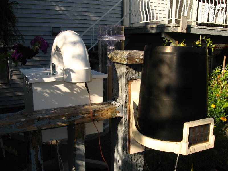

I’m wondering if my problems have more to do with the area surrounding the station than the affects of the sun itself. The house is only 15 ft away, and must radiate some heat when the sun is shining. There is also the gray painted fence, and there is the patio, both of which likely radiate some heat. I can touch the fence and it feels warm when the sun is shining on it.
I’m very limited in where I can put the sensor. The only other option would be a post in the middle of the lawn, but there’s no way my mother would approve. I’m already pushing my luck the way things are now. :lol:
So… I’m going to add some vents to the sides of the box, and increase the voltage of the fan from 9V to 12V.
My daytime high today was 2.8 C warmer than the metar. The overnight low last night was 1.1 C warmer. I’d like to have both within 1 C.
I’ve attached a couple more pics…
