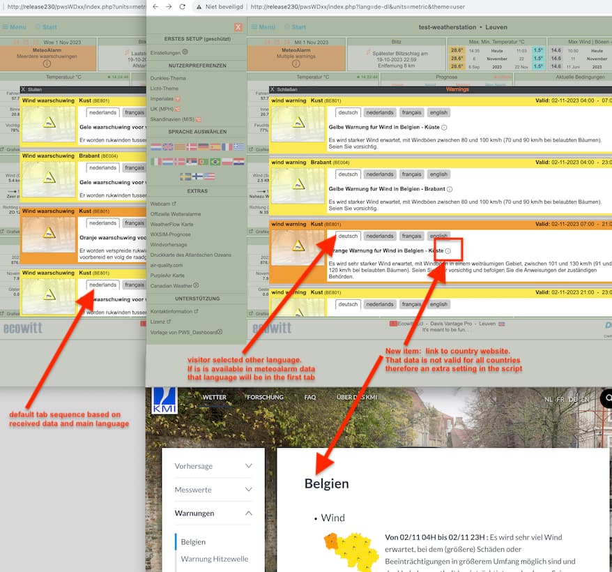

First enhanced script is available as a free download: wrnWarningEU-CAP
There was a request to make the first tab synchronised with the user language.
Also the links to the local meteo-website are back in the data and can be selected.
The 2012_lts demo website uses this script also.
