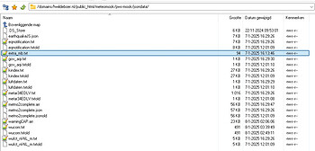

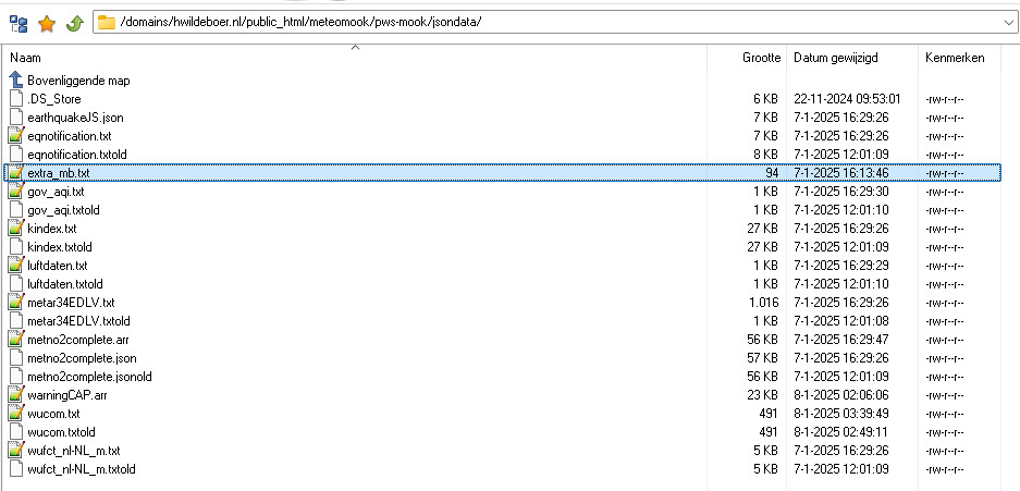

These are Hans’ settings…

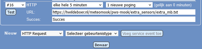

Meteobridge setting (Meteobridge.jpg) (this definitely works)
Meteobrige upload (upload weather.jpg), is this correct?
FTP (hans-mb.jpg)
Settings Eayweather (Easyweathersetup.jpg),
https://hwildeboer.nl/meteomook/pws-mook/jsondata/extra_mb.txt

Chapter 2: Instruct MB to upload the file
As an example a lightning upload from MB to a demo dashboard
Now use the example-image and fill in the fields as explained below:
  • MB tab “Services” → “Events” at the bottom select New
  • Select FTP-upload which is the normal way of upload, not HTTP
  • Select Event-Type periodical and click new
  • In the new event: Select 5 minutes as the temperature does not change that much
  • For Template: https://hwildeboer.nl/meteomook/pws-mook/_my_settings/extra_mb.txt
  • Path " whatever is used in other FTP uploads" to /jsondata/extra_mb.txt
